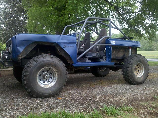

- I picked up a set of new 36 TSLs on steel wheels, and put them on..
- Ive gotten the rearend welded back in place, just need to put in the rear shaft
- put in a 3core alum radiator, with stock fan & spacer, and new rad cap & stat... think I have the cooling issue solved
- picked up a lockright for the front, just need to put it in
- put the propane on
[Image: 6113fb0f-b04d-9a5b.jpg]
[Image: 6113fb0f-b06b-b1f0.jpg]
[Image: 6113fb0f-b0da-3649.jpg]

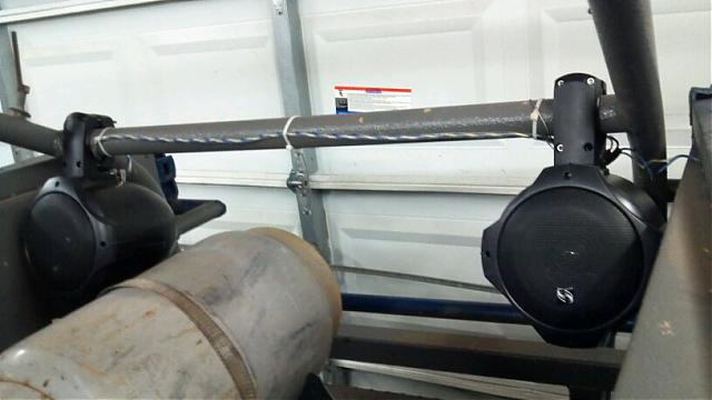

Added some tube...
[Image: aefcb7ad-a66d-7ba4.jpg][Image: aefcb7ad-a67e-71f3.jpg]
[Image: aefcb7ad-a6aa-e6d1.jpg][Image: aefcb7ad-a6c3-668d.jpg][Image: aefcb7ad-a6d1-9d6e.jpg]
and picked up a few goodies...
[Image: 61529f4a-bb00-2ee3.jpg]
[Image: 61529f4a-bb13-789e.jpg]
holy cut the quarters batman!! you're doing a good bit of work. looks good. any plans to head down to the gulches with us??? sounds like something is brewing.
hell yeah, that looks awesome!
well as you can see in one picture, the quarters were basically rust covered with half inch of dough... after i trimmed them some for travel and a tree got ahold of one side they just needed to come off... plus i am linking the rear at the moment...
more tube and sheet metal will be added once i get the rear in place... and i am going to try to make it look like there are quarters still there...
i have been trying to get down to the gulches for a few months now... there are a number of people going Presidents Day weekend... if I can get the rear wrapped up I might try to ride down...
