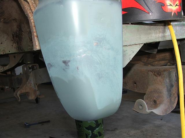

I built legs that slide into the frame horns of the 72 frame so I could roll the body in and out of the garage. I've cut out and replaced the floor pans, tunnel, and seat platform. I've replaced both inner rockers,kick panels, and front door posts. Since I was removing more metal than keeping, I decided to get it media blasted after I'm finished removing what metal needs to go.
