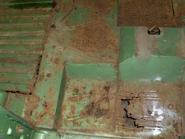

Ok, as i get older things change some. I have scrapped my 1969 for its body parts. The tailgait, grill, fenders had all been saved for Pe'pe. The tub I have been saving is fine, it just needs more time than I realy want to put into it.
The 69 is under powered and I dont have the money to build both.
So I have moved the door inserts to Pe'pe and I have to say I realy like them.
Stay tuned as I start stripping down the tub and fixing it so I can put doors on it. I will be posting some parts for sale so stay tuned for that too.
I have included some pics of what i call my final version. Now I tear it all down, fix the rust and make it all perfect.

I may have missed out on the URE run but I have been busy, I fixed the damage to the new frame, added a brace for the steering box, cut off the stock shock mounts, blasted it. I picked up some special inside frame paint and a gun to shoot it inside the frame. I also ordered a rust treatment paint (just like Por15). It comes in colors so I went with gray (like the bumpers). I will also use that paint on the underside of the tub.
The only thing this tub needed was hinge posts, I cut off the drivers side and welded the new one in. I realy should have done this when i put the new rockers in, especialy since I had to just about remove them to get the hinge post in.
I have cut off the pass side and am working on the reassembly. The next thing is to clean up some spots on the windshield frame and the front clip. I need to cut out the rad support for all my coolers. Then its going out side to be blasted.
