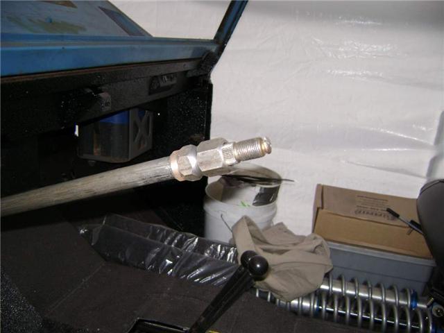

Here are a few pics of how we cut a stock steering shaft to lose all of the shifter mess. We are using the stock lower bearing and added the 3/4" heim to center the column. We still need to add a sleeve with set-screw to keep the shaft from sliding down.
