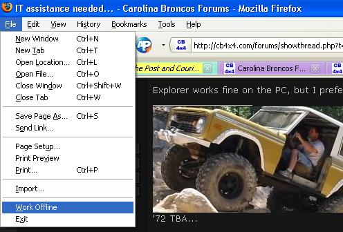

Check the Work Offline setting, sometimes the browser will loose internet and go into this mode.

Work Offline settings are alright.
