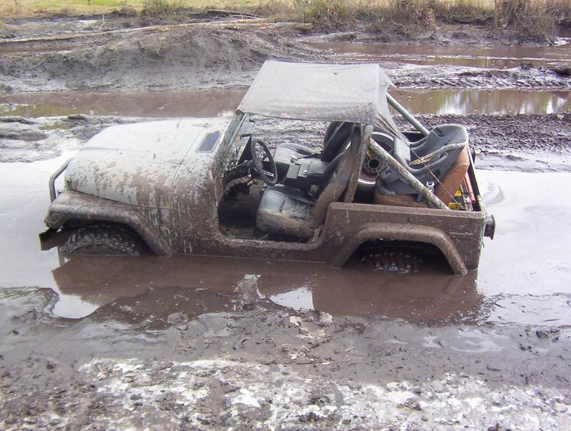

I used a lap belt that was bolted through supports in the floor. A secondary ratchet strap, just there for piece of mind, that was hooked into seat slider cross-mounts and large washers.
With the angle of the lap belt pulling down and to the rear of the seat, I never had any problems.
[Image: 100_4823.jpg]
That is an awesome picture!!!
