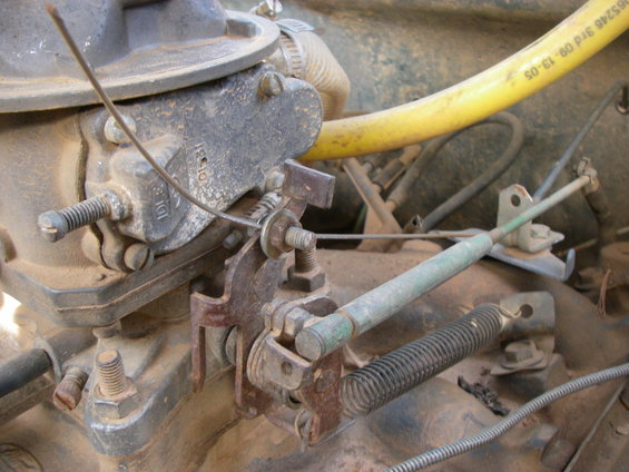

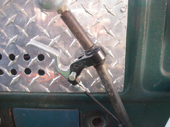

thanks guys, I was working on mine today. Even got it finished... sorta!
I have the trail banger shifter, so I thought it would look nice having the cable clamped to the connecting bar. So i drilled and tapped two 10-32 holes to mount clamps and routed everything nicely. Use a short(2.5") light small chain connected to the lever on the carb and then to the cable. Just forgot one small detail...give yourself slack!!!!! So now when I got to reverse, the darn motor revs up. Guess, I will be fixing that on Sunday.Chuck

I got this fixed today. I bought a new cable and hooked it all up. I can shift every gear and everything works good. It is a little hard due to heavy return springs on the carb, but I should be able to lighten those up some. I'll post a few pics later,chuck
