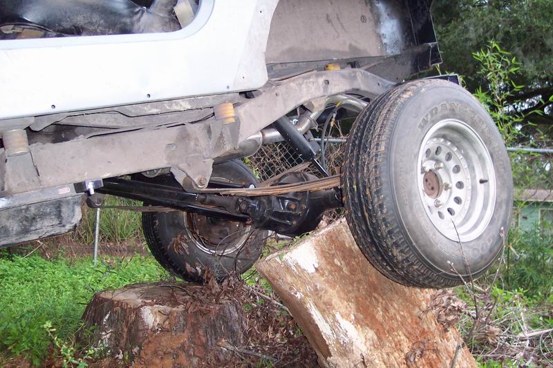

Here is the one I ran on my 9". I had solid bushings on the axle end and 2 hiems on the pivot/shackle. It stopped all my axle wrap and did not bind the articulation.
[Image: Tractionbar.jpg]
[Image: Tractionbarbracket.jpg]
[Image: Tractionbarshackle.jpg]
Nice and thick tube, bushings on axle end. 1/4 elliptical shackle on frame side. Mounted a few inches away from the pumpkin. Matched the driveshaft angle and worked awesome.
[Image: 1-nov-05-7.JPG]
[Image: 1-nov-05-3.JPG]
