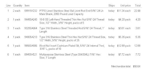

I'll put something up. Let me get the parts list together.

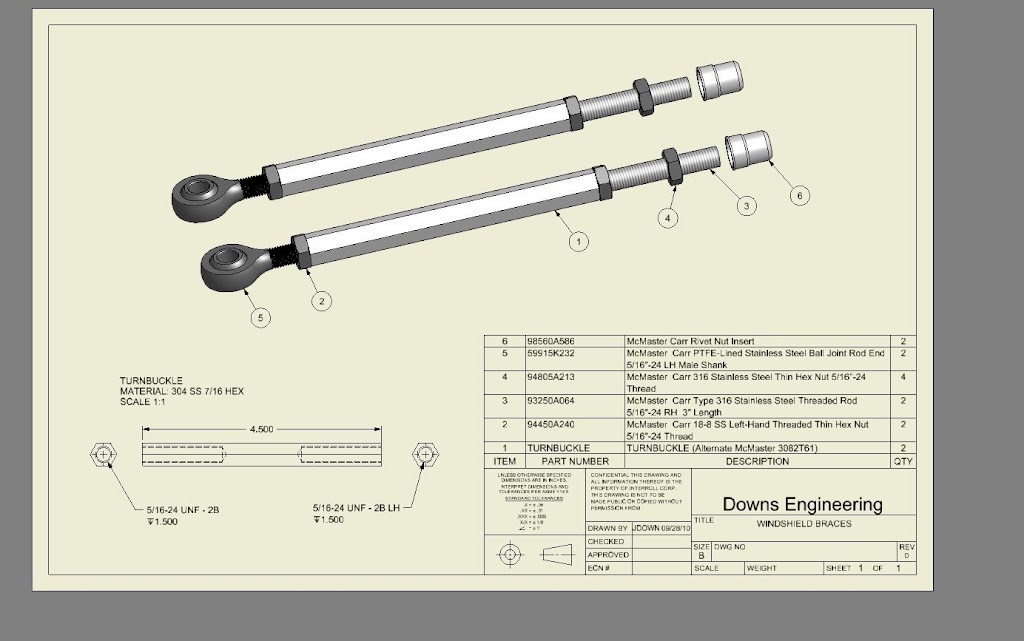

Don't know how well this will work but here it goes.

wow...nice drawing! so how much total did it cost? i went a way cheaper route(from Lowes) but it didnt look good at all...that really looks nice. Great job! thanks for sharing,Chuck
x2 on the cost and where did you get the parts from?
JD, great drawing....but, how about the nutserts? Are they McMaster-Carr parts also? Can you provide us with their description and P/N. If you would add them to the drawing, then everything required for a workable set of braces would be detailed all in the one document....:xyxthumbs:
