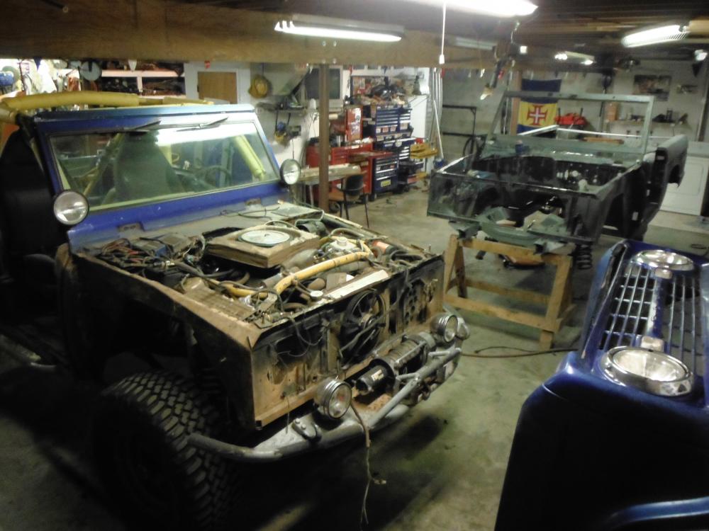

So once again it is time to tear it down and rebuild it. This time I hope it to be the last time as I am taking the time to realy do this right. I do have a few upgrades I have been planning for some time as well as some simple mods to refine the enjoyment of driving it. Stay tuned as I will be posting bunches of pics of the build as well as the changes.
For now I am starting with a diffrent body and frame, I have been hanging on to it for some time and now that the roadster is as done as I can afford to for now its time to start on the body.
And so it begins.....

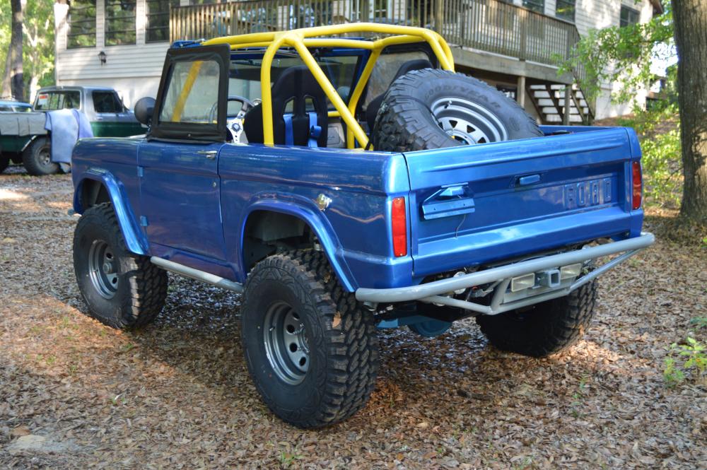

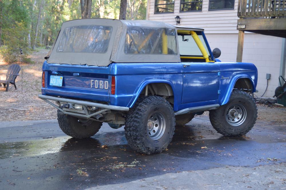

I have included some pics of what i call my final version. Now I tear it all down, fix the rust and make it all perfect.

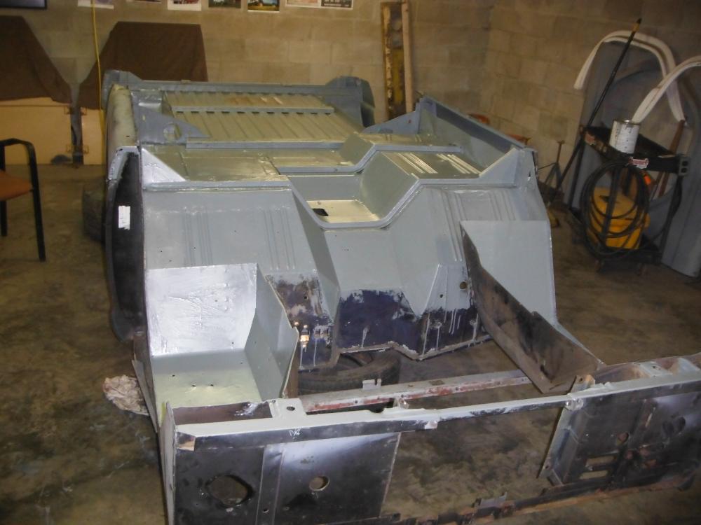

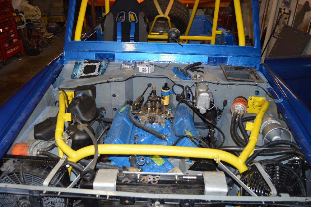

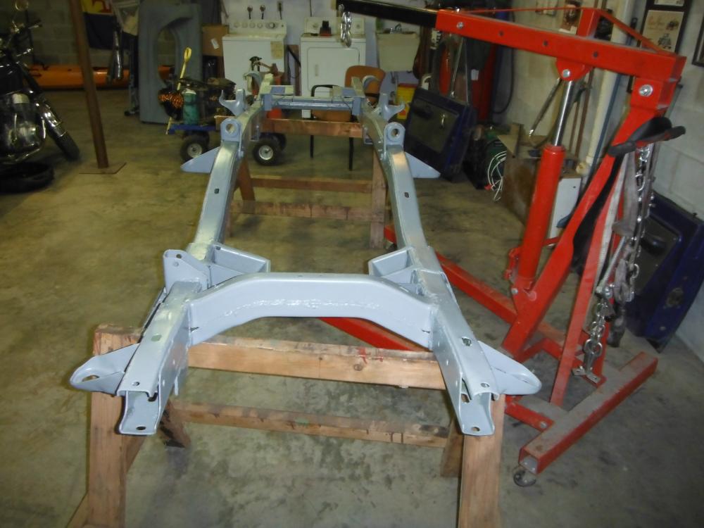

I may have missed out on the URE run but I have been busy, I fixed the damage to the new frame, added a brace for the steering box, cut off the stock shock mounts, blasted it. I picked up some special inside frame paint and a gun to shoot it inside the frame. I also ordered a rust treatment paint (just like Por15). It comes in colors so I went with gray (like the bumpers). I will also use that paint on the underside of the tub.

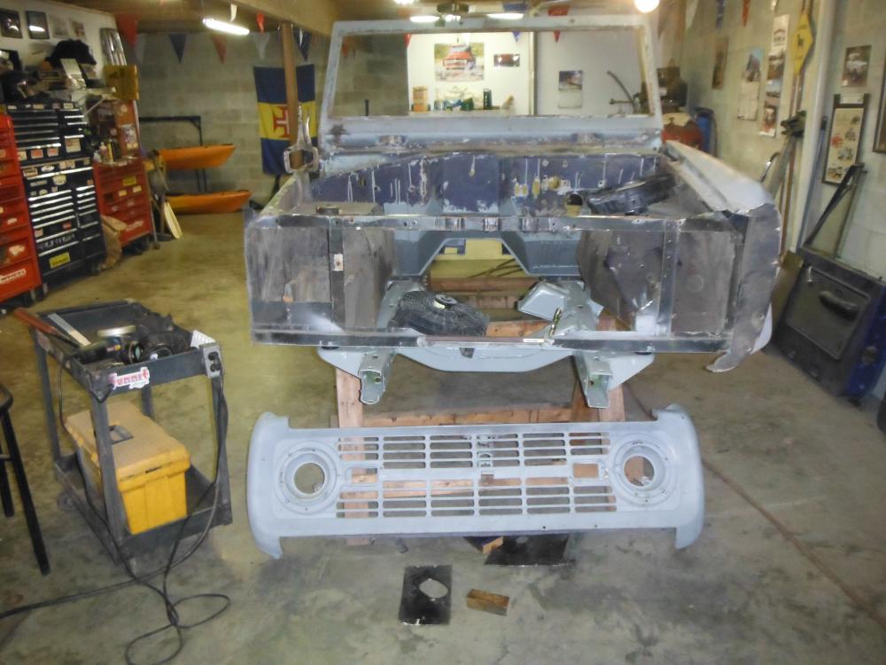

The only thing this tub needed was hinge posts, I cut off the drivers side and welded the new one in. I realy should have done this when i put the new rockers in, especialy since I had to just about remove them to get the hinge post in.
I have cut off the pass side and am working on the reassembly. The next thing is to clean up some spots on the windshield frame and the front clip. I need to cut out the rad support for all my coolers. Then its going out side to be blasted.
I'm going with fiberglass rear fender flares, I want to try the new epoxie's that are out for bonding body pannels insted of the usual rivets. I will let you know how it comes out.

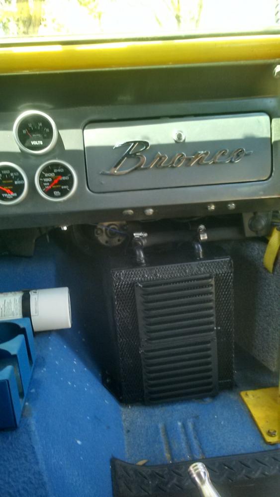

I forgot to mention the dash project. My truck orginaly had an aluminum pannel for the dash. I want to use the stock dash and OE heater. Since all the switches are in my center consol all I need to leave is the stock heater controls. I am going to move the glove box door over to clear the roll cage. Going to delet the speaker cover to leave enough room for all the guages I want. From what I have now I will still be deleting 2 guages, but I will still have room the importent ones.
