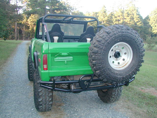

Well, she's done. I wanted to go with John Deere green to complete the putt-putt theme, but the color didn't cooperate. Here's a few pics.
