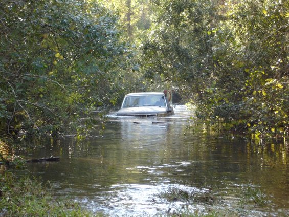

I'm really not planning on doing this, but I finally found a picture of my buddy Jimmy using his snorkle during a Richloam ride...the engine stalled, but cranked right back up once he was back on land. E4OD #3 was a different story, tho... :crying:
[Image: dsc00457.jpg]
