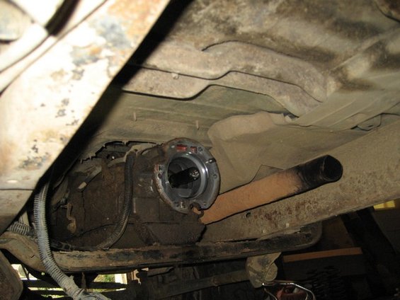

do any of you guys happen to have a pic of where the Tcase and trans mate up?
thanks again!
this is the best that i have
[Image: img_0816.jpg]
thanks! i should be able to tear her down and replace the seal (rtv) and have her buttoned back up in no time...
still worried about the trans being burnt up.. I'll update
thanks again fellas!
welcome to the group. unfortunetly there is more than rtv to the output shaft. It will need a true seal, and probably a bushing. I would still opt for the used tranny, and I still like the c6
the mating flange uses an actual seal?
if so cant cost that much... but thanks for the heads up.
The seal may actually be on the input to the transfer case. It is there to keep the tranny fluid in the tranny and the transfer case oil in the transfer case.
