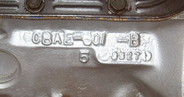

[IMG]casting code[/IMG]
This is what my code looks like by the starter. As for the valley I do not have the motor apart. Is there any way to know if this is original to my truck without the other one? Thank you so much for walking me though all of this.
How the hell do you add a picture. any way mine says c8AE-601-B
A big #5 8B27
I'm going to say the 8B27 is the build date, 27th day of February 1968. Not saying it is not original. Ford used a lot of surplus/left over parts in the early Bronco's.

figured out how to post pics
