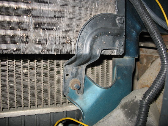

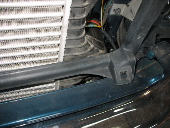

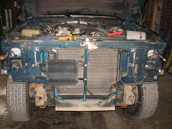

Before. You can see the location of the tranny cooler before the install.
[Image: img_0156.jpg]

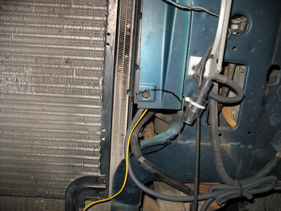

Strip the front end. You need to remove everything. It isn't as hard as you think it is, just a pain to get to some of the screws.
[Image: img_0164.jpg]

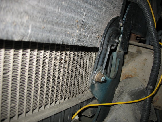

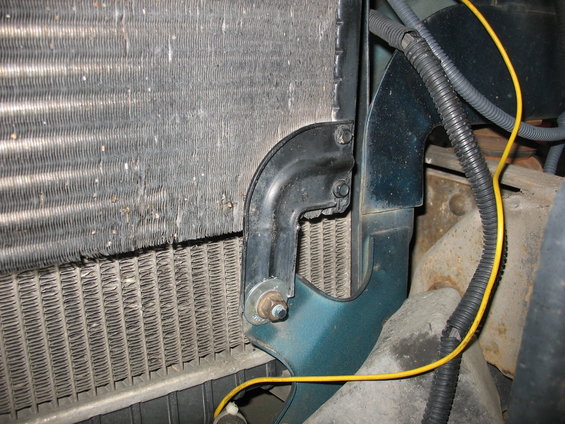

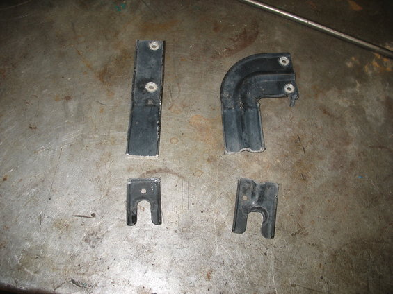

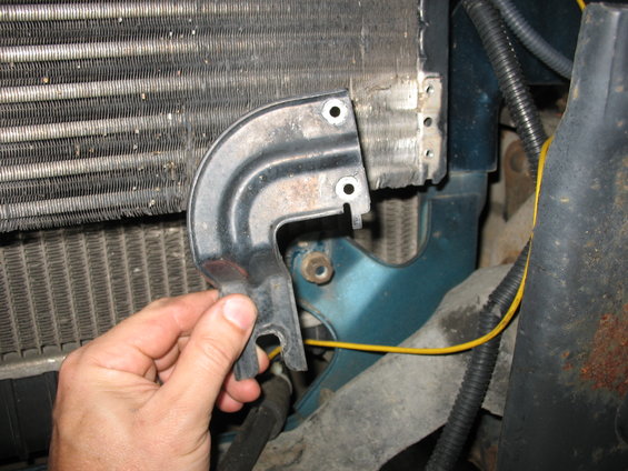

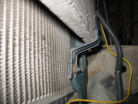

Remove the lower AC condesor mounts.
[Image: img_0169.jpg]
[Image: img_0171.jpg]
[Image: img_0173.jpg]
Flatten them out.
[Image: img_0176.jpg]
Cut them
[Image: img_0180.jpg]
[Image: img_0184.jpg]

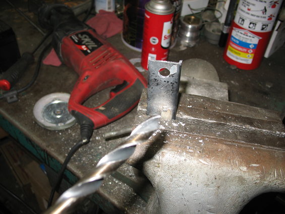

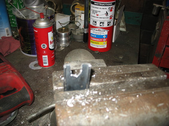

Re drill a hole in them. I went ahead and slotted it like it was before. Just quicker and easier to reinstall that way.
[Image: img_0186.jpg]
[Image: img_0187.jpg]
Reinstall them.
[Image: img_0188.jpg]
[Image: img_0191.jpg]

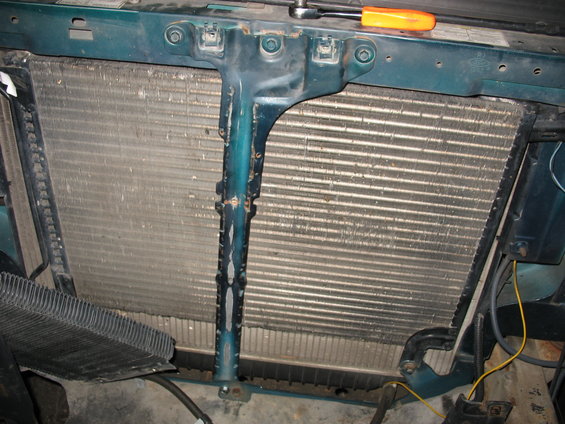

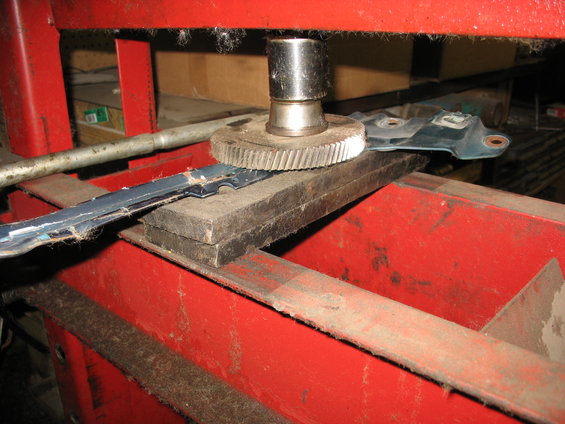

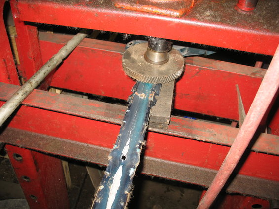

There are different versions of how to do the radiator/hood latch support. I took the original out of there and flattened it in a press.
I have seen other guys cut this off and weld a piece of strap in.
[Image: img_0194.jpg]
[Image: img_0195.jpg]
Reinstall. I had to cut about 1/2 inch off the botton, and re drill a new hole for it. The bottom is also now mounted inside the lip of the lower radiator support, instead of on the stud on the outside.
[Image: img_0199.jpg]

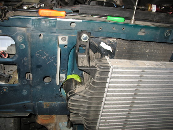

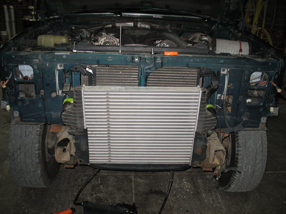

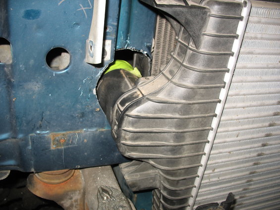

Start test fitting, trying to figure out where the tubes will stick through at.
[Image: img_0205.jpg]

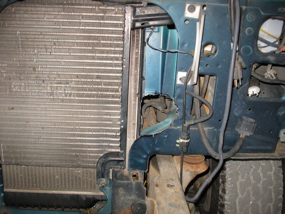

Mark the holes where you need to cut. One thing I didn't see clearly mentioned in other writeups, you have to cut into the flanges on the radiator and lose the lower mounting holes. Moving them up a couple inches.
Not a big deal as the radiator is mounted securely at the bottom as well.
Rough marker outlines
[Image: img_0206.jpg]
[Image: img_0207.jpg]
Hack it out of there.

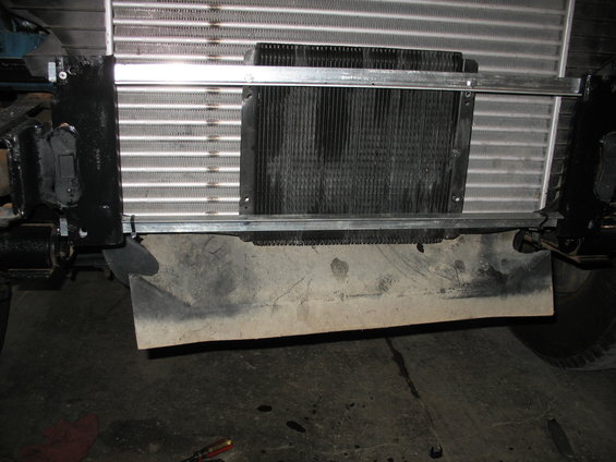

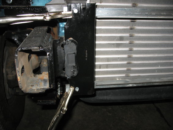

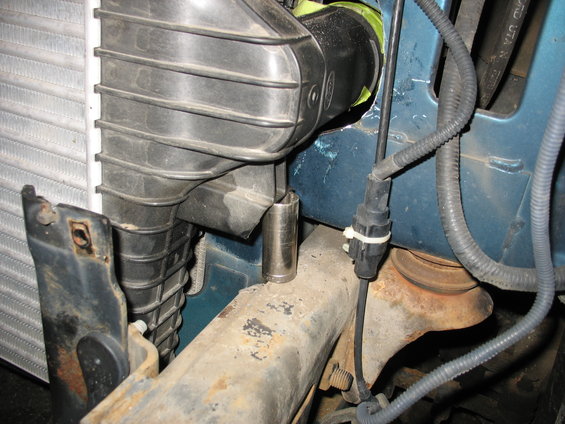

Start mounting it up. I first shimmed it in place. I set the lower mounts on 3/8 drive deep sockets seemed to be pretty close.
The upper mounts are vibration dampners I bought from Gringer, I have read where guys used old shock bushings. It is really the same thing.
[Image: img_0233.jpg]
[Image: img_0235.jpg]
[Image: img_0236.jpg]

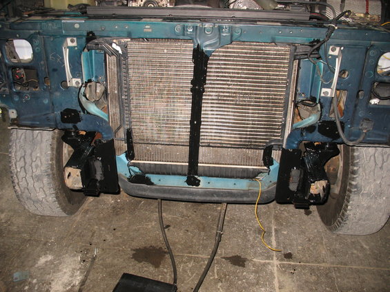

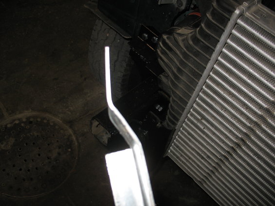

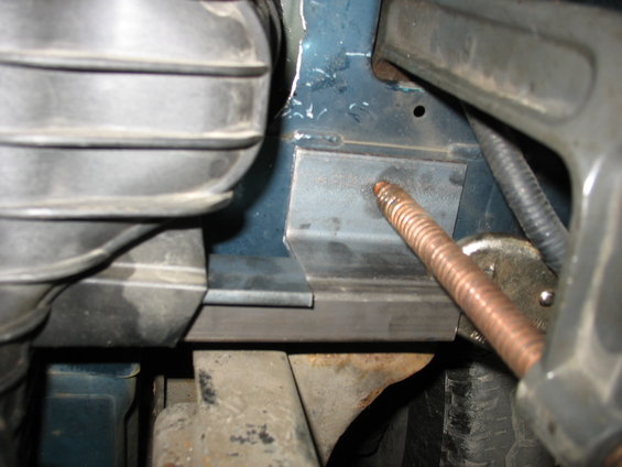

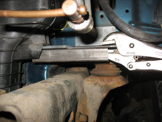

Start building your lower mounts. I used a piece of 1.5" angle, 1" box tubing, and a piece of strap. Clamped it all together and welded it up.
There are other ways to build the lower mounts, I like this because it holds the intercooler tight and the mounting bolts are easy to access.
[Image: img_0237.jpg]
[Image: img_0238.jpg]
Tack it together and test fit it.
[Image: img_0241.jpg]
At this point I took it to the wash bay and cleaned everything up. Cleaning the radiator and condensor. Then I painted any bare metal to prevent rust. I also painted the frame horns.

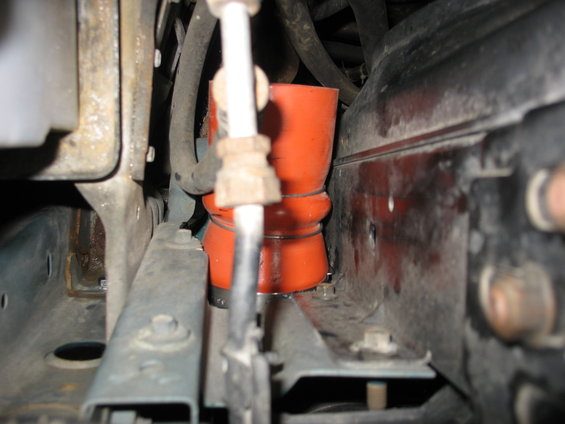

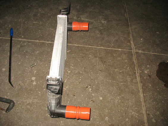

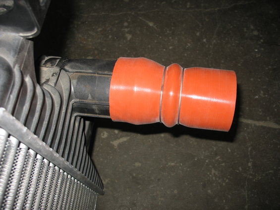

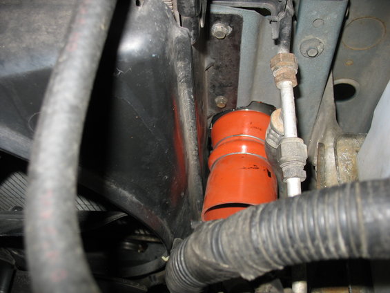

Slip the boots on your intercooler. I used 2 3"x3" boots with constant torque clamps. You need to install the clamps now because there is no room to tighten them later.
[Image: img_0247.jpg]
The intercooler has what is now the outlet size of 3 1/4" There is a boot made just for that, but I did not have any trouble slipping the 3" boot over it.
[Image: img_0248.jpg]
Install it. You can see how the clamps are hidden. I had to remove it and turn one clamp a little so it wouldn't rub.
[Image: img_0252.jpg]
[Image: img_0253.jpg]
[Image: img_0255.jpg]

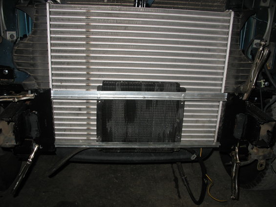

Placed the tranny cooler. I centered it, I thought it would look better than off to one side.
Bolted it up to the angles.
[Image: img_0265.jpg]

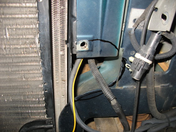

Re run all of your electrical and tranny cooler lines now.
[Image: img_0271.jpg]

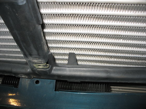

I still had the rubber flap below the radiator. I reinstalled it. It helps direct air flow through the tranny cooler, intercooler and radiator. It also helps keep and mud from splashing up in there.
I had to trim it at the bottom to fit.

Hopefully you have been checking and rechecking your clearances along the way. It is a tight fit.
[Image: img_0287.jpg]

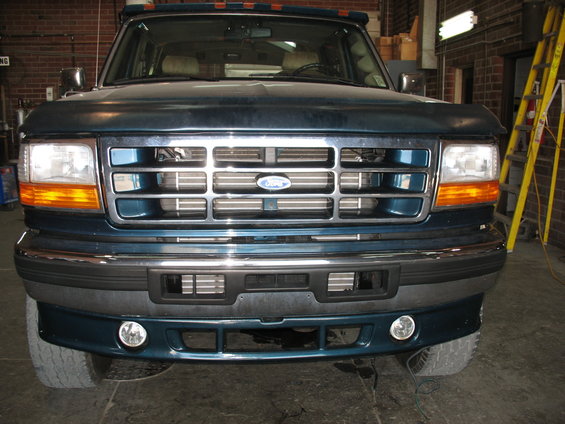

Finished product.
[Image: img_0291.jpg]
