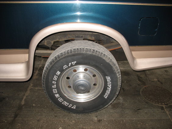

Jack up the rear end.
Pull the axle shafts out far enough that you know they are not engaging the carrier.

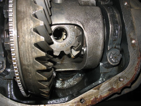

Pull the Diff cover
[Image: img_0117.jpg]

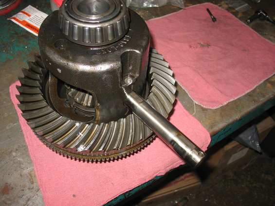

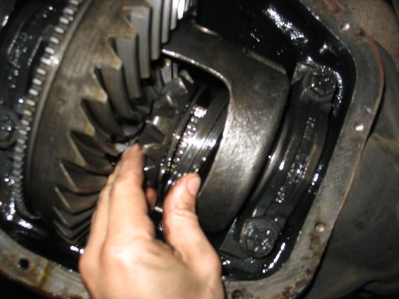

You won't have to pull the carrier, but this is normally how I remove them.
[Image: img_0122.jpg]

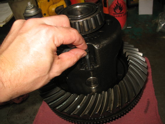

Pull the pin
[Image: img_0131.jpg]
[Image: img_0132.jpg]

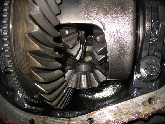

This is where you spin the spiders out. I couldn't do it on the bench, so I reinstalled the carrier, and started the axles back into the carrier. With the truck in park, rotating one tire will roll the spiders out.
[Image: img_0134.jpg]
[Image: img_0135.jpg]

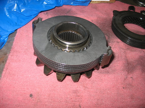

Pull the side gear and clutch packs out.
Had to pull the passenger side first and put it in last.
[Image: img_0136.jpg]
[Image: img_0140.jpg]
[Image: img_0143.jpg]

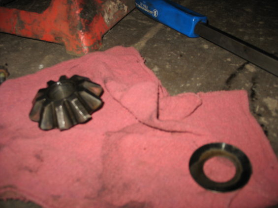

I did a lot of reading about adding extra plates, and other ways to stack them, maybe because of the kit I have or I am not sure but there was no way to get another plate in there. Maybe my old ones were not worn enough. They didn't look that bad when I took them out.
[Image: img_0144.jpg]

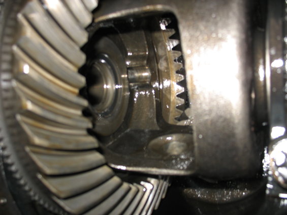

Now the tricky part. You have to start your spider gears together. They have to be timed the same in order to line up with the cross pin at the same time.
Once you do that, start your axles and roll them back in, like you took the out.
[Image: img_0147.jpg]

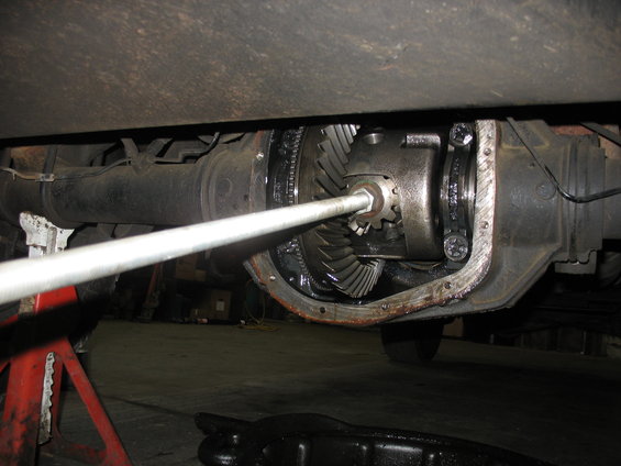

I had problems with the tips of the spider gears catching the housing and I could not rotate past it, so I used a piece of all thread to compress the spiders and roll it past that point.
What happens by doing this, well it is actully compressing the spring plate in the clutch packs.
Another way to do it would be stick all thread through the axle tube and nut it on the inside of the side gear, and on the outside of the axle tube.

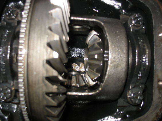

[Image: img_0148.jpg]
I got it past the really sticky part, now saying that, it wasn't easy going the rest of the way, but it was a lot easier.

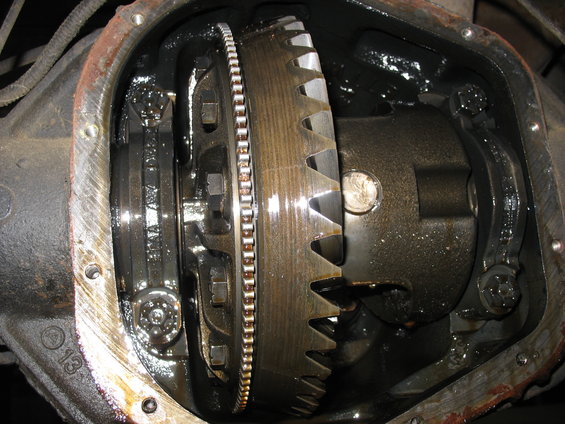

Don't forget to put your shims on the back of the spiders when you finish rolling it the rest of the way in.
[Image: img_0150.jpg]

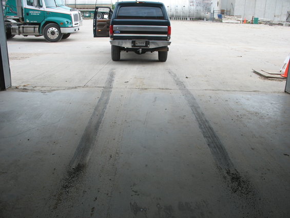

Install the cross shaft, and retaining pin. Fill it and you are done.
It works.
[Image: img_0154.jpg]
