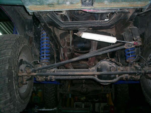

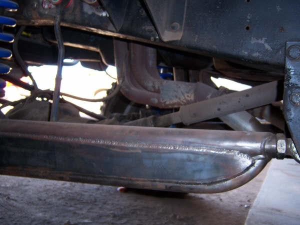

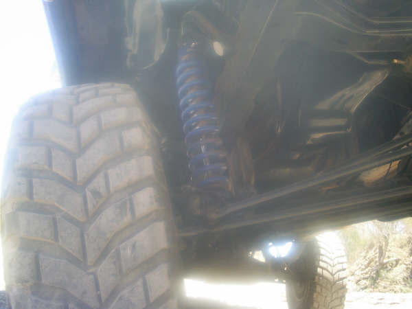

Hi my friends im new in the forum and im have a question, a couple of months ago, me and my friend Fili do the fixing of my front suspension, but my friend donts remove the front sway bar, in this time i dont have a chance to probe the flex of mi suspension, Im bought this car 1 year ago and little by little im gonna fixing all the little troubles, and i want the truck for long travels some times in the highway and some times in the off road, so i want a truck whit enough cappabilities on and off road, please if any body can help me ??? sorry for the bad spelling im from mexico. GRACIAS AMIGOS!!!! Confusedcratchhe:Im attach some pictures of the work thanks!!
1st off welcome aboard!!!! Thank you for joining up...I do believe you are our 1st "far away" member :xyxthumbs: Im a little confused as to what you are asking, but I think it pertains to the sway bar. The sway bar should be pretty easy to remove. I love the coil over conversion...the welds look nice!:notworthy: we need some more pics of that bronco,Chuck

Love the coil over conv.:notworthy:

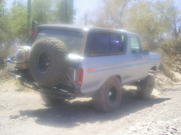

Thanks my friends. Yesterday i take a little ride, im not disconect the sway bar already, im think the bronco power its awesome, and this are the pictures, and about the pictures of the coilovers conversion im gonna take more pictures friends, thanks for everything !!!
sweet looking bronco!!!!
blazinchuck Wrote:sweet looking bronco!!!!
Thanks my friend!!! its really nice this forum all the people here loves Bronco's and me too!!!
