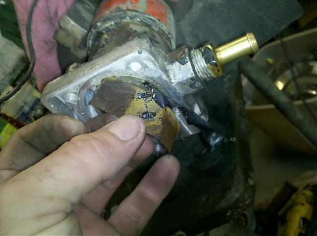

came home to try something else. i found out today the holley red pump had a small filter/flame arrest screen internal.(never knew that, ive been using this just over a year, cant imagine the PO checking it for the 4 yrs head had it)
the pic should say enough!!!
it looked like a strip of elec tape jammed between the screen and inlet side of housing!! but it wasnt tape, it had numbers printed on it like it was part of the original gasket. removed it and cleaned the housing and screen.
