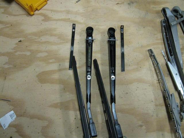

I pulled the washer fluid squirter hose off and tossed it. Then I installed the new blade on the new arm and held it up to the glass and mocked it up where I expect it to run. Basically this means it's centered on the glass. Since the Cherokee arm is too long and will need shortened, I measured from the wiper pivot to the socket on the wiper arm, and determined that I would need to remove 4 1/2" in length. This length will vary depending on the length of wiper blade you use.
I drilled out the rivet and shortened the arm by 4 1/2" each. I redrilled the holes, and re-riveted the arm back together using a 1/8" stainless steel rivet with a backing washer.
Then I reinstalled the springs, assembled everything, and timed it on the windshield.
Picture 1 shows how the Cherokee arm is much longer than stock.
