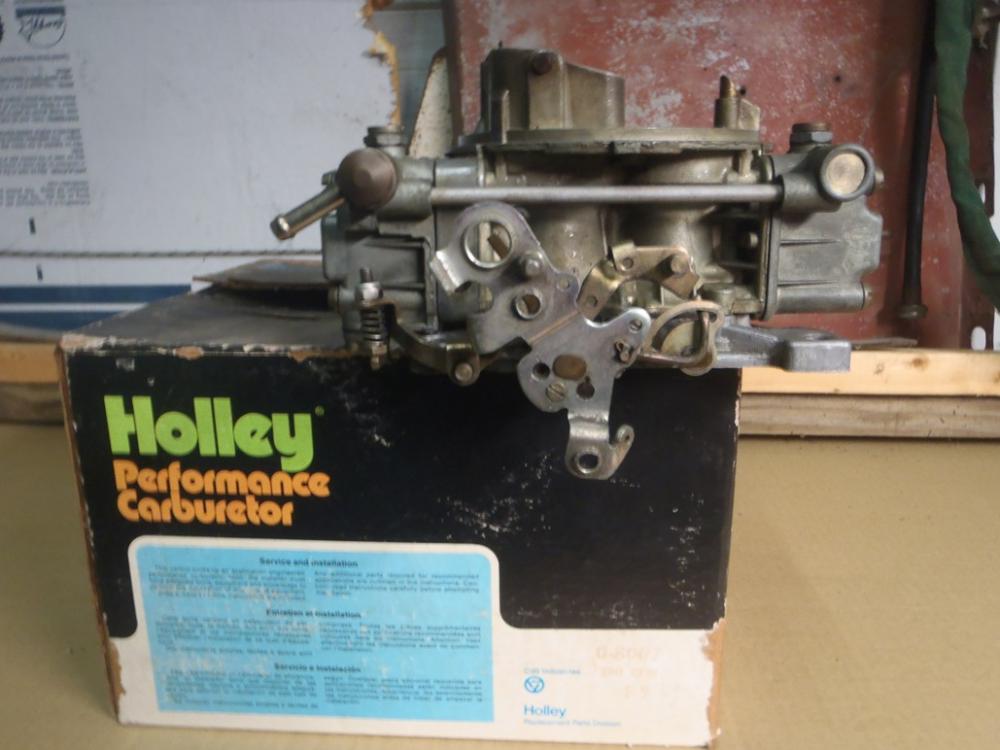

Looking for a Holley 390 cfm carb
Anybody got a decent Holley 390 cfm four barrel or similar carb? I've got an Edelbrock #1903 Q-jet carb to trade. If not looking to trade just let me know how much you are asking.
