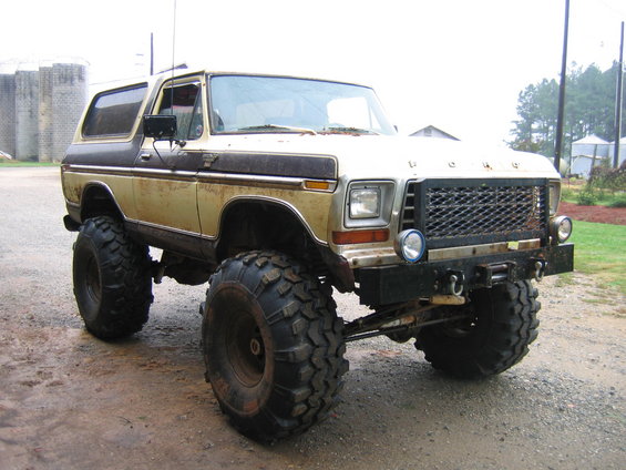

06-19-2008, 09:13 PM
(This post was last modified: 06-19-2008, 09:15 PM by broncomania.)
here is how it will sit on 6" superflex coils and rear 6"superflex springs
thats with a 3" bodylift on 44" tires trimmed fenders my old 79
06-19-2008, 10:51 PM
thats the set up i'm goin for ,thanks
06-21-2008, 06:07 AM
so the super flex 6" really ends up measuring 9" of lift on a 79? how did you like those superflex springs, mania?
~Joseph
06-21-2008, 12:13 PM
79BlueMule Wrote:so the super flex 6" really ends up measuring 9" of lift on a 79? how did you like those superflex springs, mania? pretty close to 8/8.5" they rode very good down the highway. my bronco had a 460 , one tons , 44" tires and i could pass cars on the highway in a 70 mph zone and maintain speeds of 80 mph with no problems. they flexed very good especially with the cage arms. but the rear didnt flex as good in very rough terrain. but did fine at ure.
