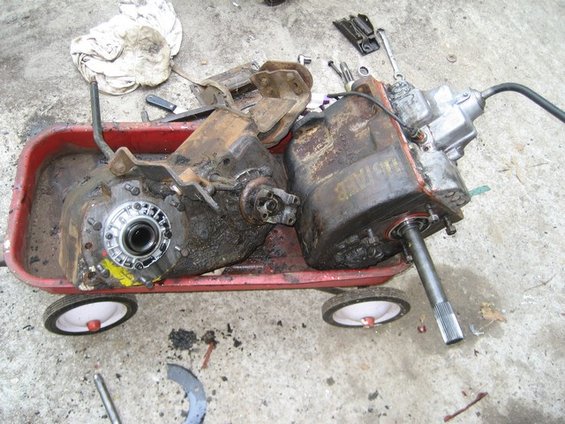

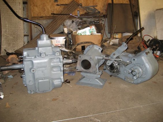

Thanks to Aaron (bucketobolts) this followed me home. 1977 NP435 & NP205.
[Image: img_0760.jpg]
A little disassembly & cleaning
[Image: img_0787.jpg]
[Image: img_0789.jpg]
[Image: img_0793.jpg]
Few coats of paint
[Image: img_0791.jpg]
[Image: img_0794.jpg]
[Image: img_0797.jpg]

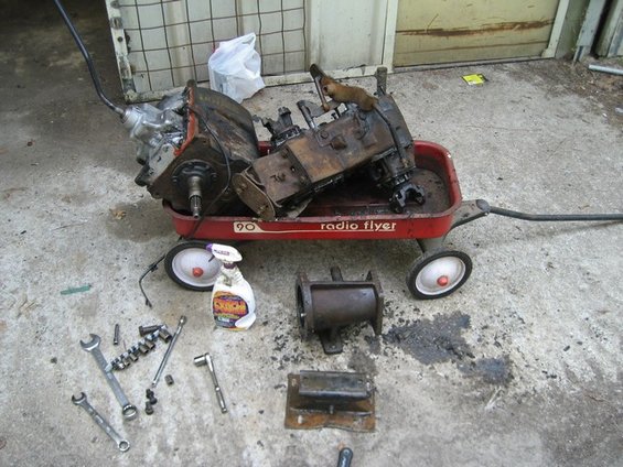

And remove the BW1356 & E4OD
[Image: img_0813.jpg]
So that's why you drain the torque converter first!! :error:
[Image: img_0819.jpg]

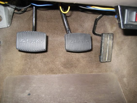

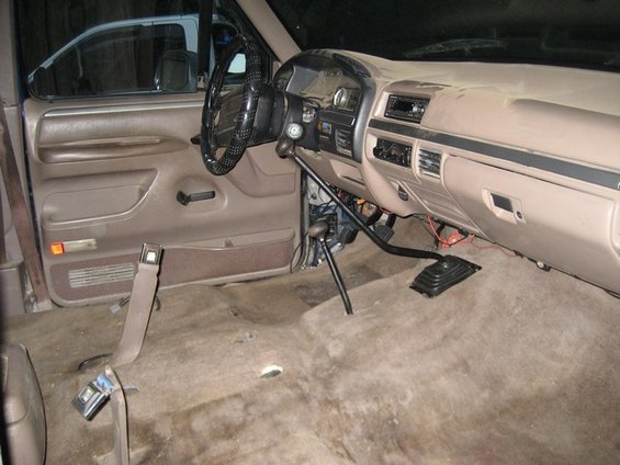

Then you switch brake pedal assemblies. I used a hydraulic clutch set up.
[Image: img_0821.jpg]

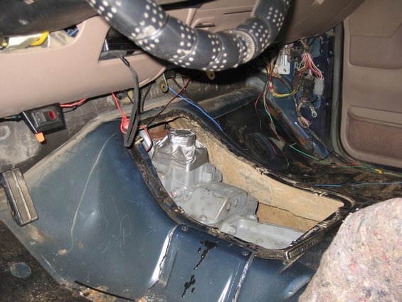

And this sorta ended up happening. It's all back together now.
[Image: img_0822.jpg]

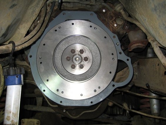

New flywheel & pilot bearing installed
[Image: img_0829.jpg]
Trans being bolted up
[Image: img_0832.jpg]
It fits!
[Image: img_0834.jpg]

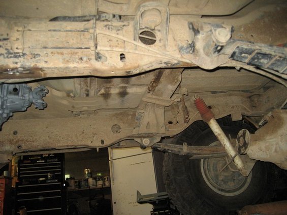

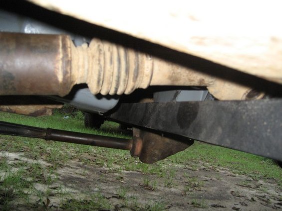

Had to make a new crossmember. It's a piece of 5" c-channel i found laying around the shop.
[Image: img_0836.jpg]

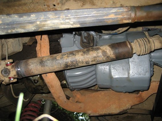

205 is bolted up, too
[Image: img_0837.jpg]
Now i'm wondering whether I should put a flange on the 205 or put a yoke on the 8.8. Either way I've gotta wait for $$ to come in first.
[Image: img_0838.jpg]

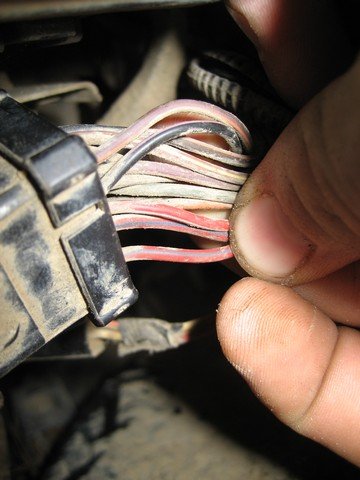

Other than that, I have to shorten/lengthen driveshafts, bypass the neutral safety switch and buy a starter. 2 of those 3 are waiting on me to find a job that'll work around my class schedule.

Gubni Wrote:Looks pretty good. Don't forget the 205 needs a mount in the side to the frame with a bushing.
Thanks!
I tried the stock mount on the 205, but it wouldn't reach the frame. Guess I'll make something else work.

i was going to weld a flat plate with a slot in it onto one part of that stock mount, so it would have more adjustment in it. But you're right, a spacer would be simpler.
