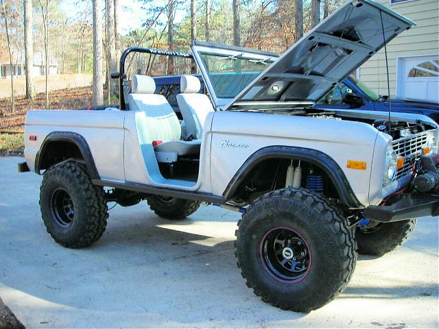

I run 37" tires with 3 1/2 SL and 2" BL and am no where near the body line. See sig pic. No cutting the inner wells and wheel just fine. It has Al wheels and they are balanced so street is no problem either. Do want lower gears but that's a leftover from the 33s that were on it.
