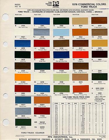

Here is a paint color chart for a 76 Bronco. It should have Wimb. White on there.
broncosbybart Wrote:Wimbledon white:
PPG 8378
Dupont 4480
I just told my paint store 'Wimbledon white'
That's what I figured it was, I just wanted to make sure it looks "right" :beer:
