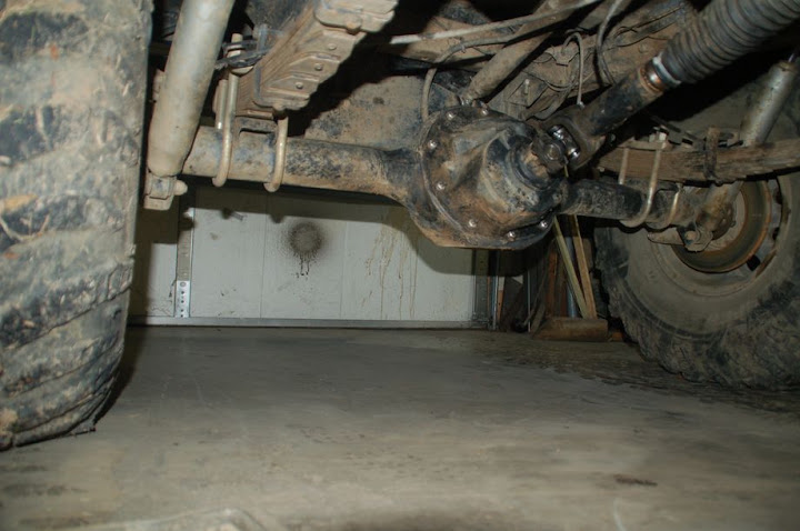

[Image: DSC_0959.JPG]
Shaved Rear End

great pics nick, i love seeing how things change on the broncos from when we first get them. wow, new tires!!!! thats awesome. i like the shaved nine and tcase skid plate
