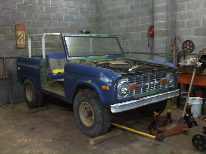

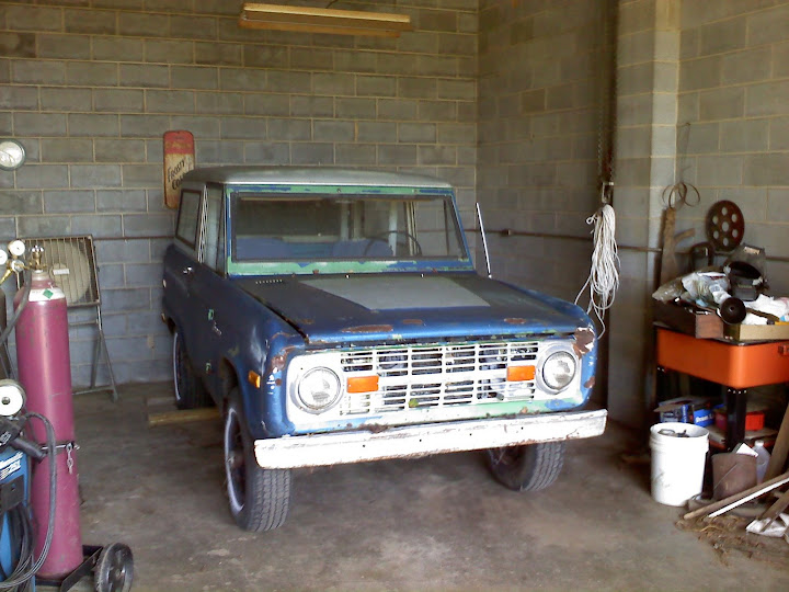

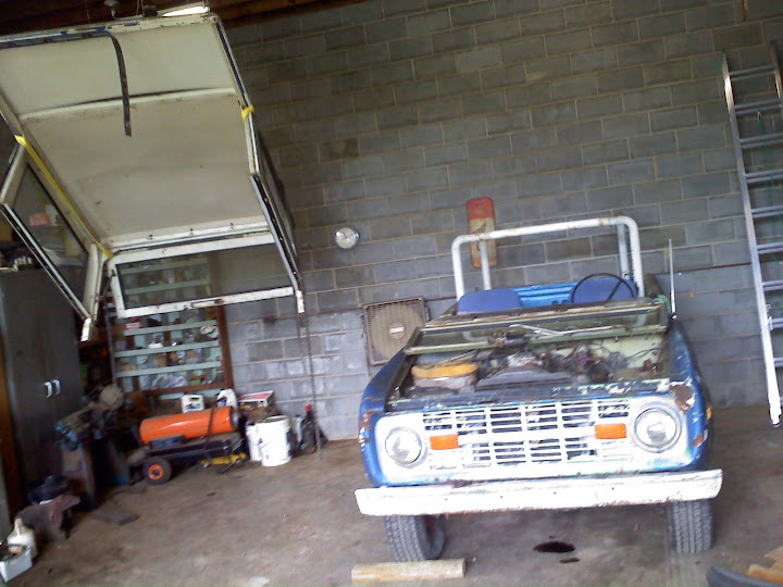

Here she is right after I pulled her in the shop.
[Image: 0905091549a.jpg]

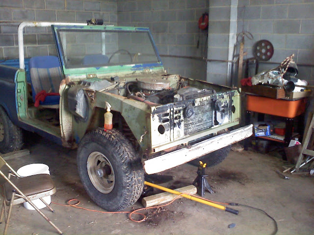

Got both doors off and a lot of the rotted away weather stripping. Looks like I'm gonna be looking at some new floor pans in the future.
[Image: 0906092029.jpg]
Pulled off the hood. A previous owner decided to put plenty of thick bondo on the front and cut the main support rib above the carburetor. I guess that intake and 4V was just a little too tall. Good thing is that I got another hood that should just need a little surface rust removal.
Used the chain hoist and some straps to remove the steel top. That wonderful 2" iron pipe roll cage in the bed just made the top removal a PITA.

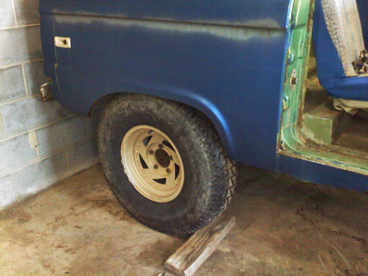

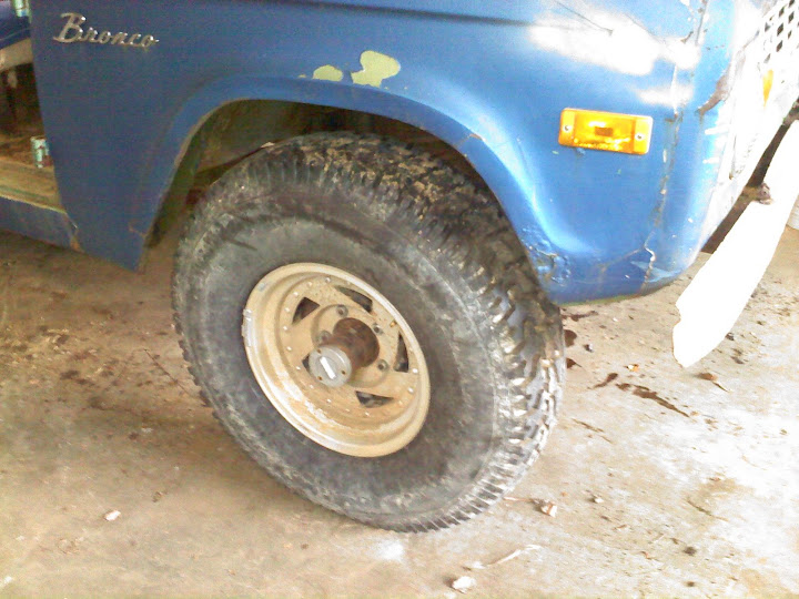

I didn't take long before I got tired of continually pumping up the old worn out tires each time that I wanted to roll the bronco around in the shop. Luckily I had a near new (blue still on the white walls) tires that came on my 78 when I bought it. For some reason they just happened to be 33x9.50x15. Perfect!
[Image: 0907091511.jpg]
They clear on concrete, but I don't think I'd chance it on much of a dip

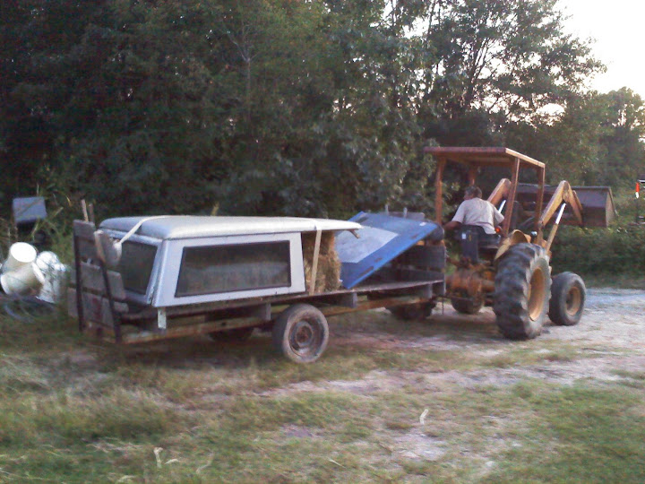

I did find out that an old tobacco trailer, half dozen bales of hay, and some straps make a nice little hard top rig
[Image: 0907091945a.jpg]

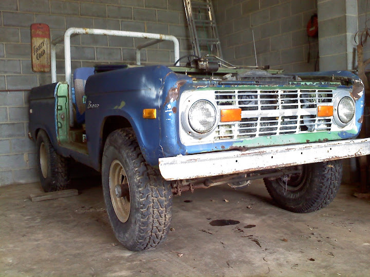

But, here she is so far. Hopefully I'll get some more done this weekend.

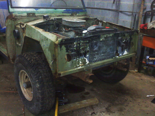

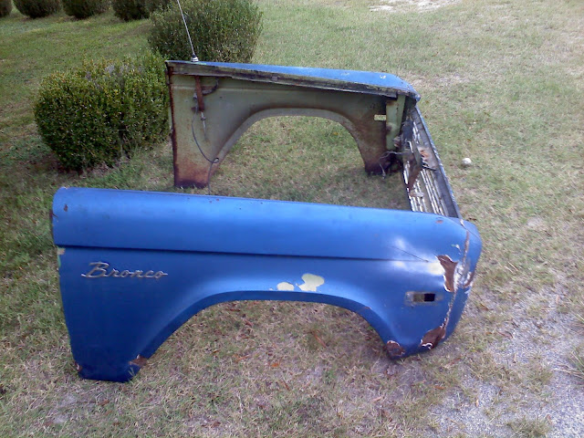

After a lot of PB Blaster and wrenching, I finally got the front fenders/grill off so that I could get a better look at those rusty inner fender aprons.
[Image: 0912091834a.jpg]

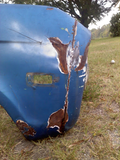

So...There's good and bad. The bad is that someone that owned it before me decided they really liked bondo and must have had a fleet sized tub. Most of the fenders are bondo.
[Image: 0912091838.jpg]
I pulled off upto 1/4" thick chunks of it! After pulling back some of the bondo at one of the seams, I found that the front grill was welded to fenders.

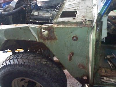

Both of the aprons are shot, but the kick panels seem to be pretty solid except the part where it overlaps with the apron:
[Image: 0912091834b.jpg]
[Image: 0912091835b.jpg]

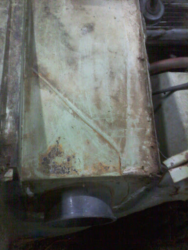

After removing the heater box intake and cleaning away a half inch of Wyoming dirt, I found an interesting line in the sheetmetal. Is this stock or what?

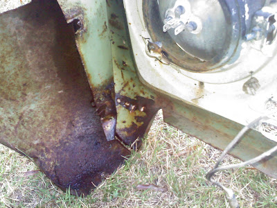

Got the front bumper pulled, but had to get out the blue wrench because somebody bent the horns up badly with what looks like some log chains they used at some point to pull the bronco.

Your lower door post look good. If it was me I would go ahead and replace the inner kick panels. While you have the old kick panels off you could buy some Por15 and put in your door post so they will not rust away. The core support in the pictures looks great. Looks like you have alot to work with. The crest that you found under your air box, I have never seen any thing like that before. Keep up the good work. What kind of Welder do you have that you are going to weld the panels back with.Wish you were a little closer. I would help you out. Maybe you could have a wrench party at your house.
Yeah, its not as bad as I thought and as bad as I've seen online. I think I will be able to patch a lot of the existing panels on the core. I might get a new set of inner fender aprons just because they are torn up and rusted in some hard to repair spots, but we'll see.
This is my first dive into bronco sheetmetal and body work in general so I'm learning as I go.
I was planning on trying to coat as much of the backside of some of the problem areas with something like por-15 or chassis saver. I was planning on just trying to repair the existing kick panels and probably replace the bottom of the front of the door posts. I guess it would be best to just remove it and the front floor boards to give plenty of access to the back of the door posts. Is that the best/only way to get into the door posts to coat them?
