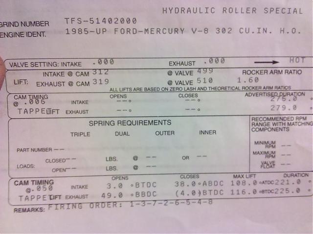

ok Aaron, what does our 306 come up with on your program?
302 bored .30 over, roller motor,1.6 roller rockers,trick flow alum heads,alum intake-port match to intake. has a 600 holley w/vac sec. but it has drilled out jets,larger squirters.L&L nickle long tube headers. i attached the cam spec sheet
#29
Do you know what the compression is?
#30
yeah, sorry...10:1
